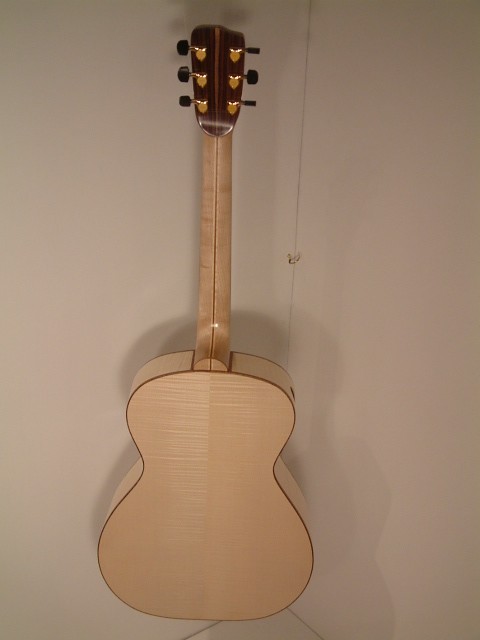

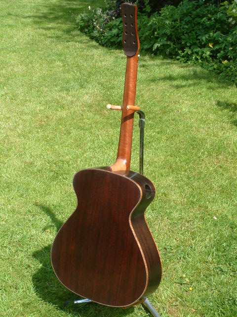

Andy,
Sycamore in North America is what we call plane - usually London plane in Europe. Sycamore here in Europe ususally refers to a variety of maple. Here's one neck I did with it:
Here's a Sapele neck with a London plane heel:

Beautiful guitars Dave and thanks for the pics. They give a better idea of what these woods look like and to me they're both wonderful.
